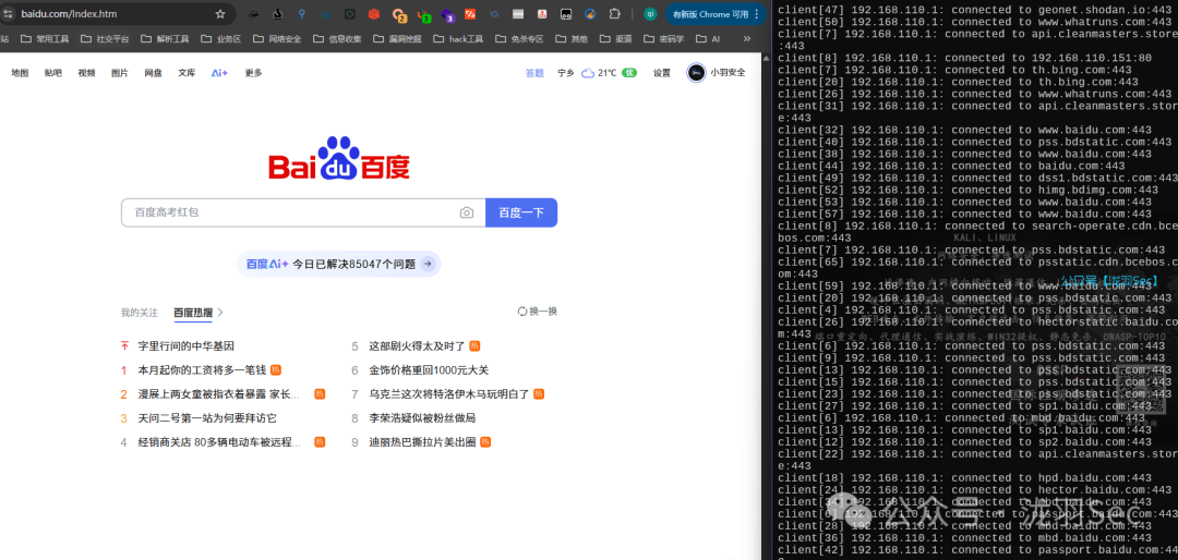

image-20250603002208002
image-20250603002452968
