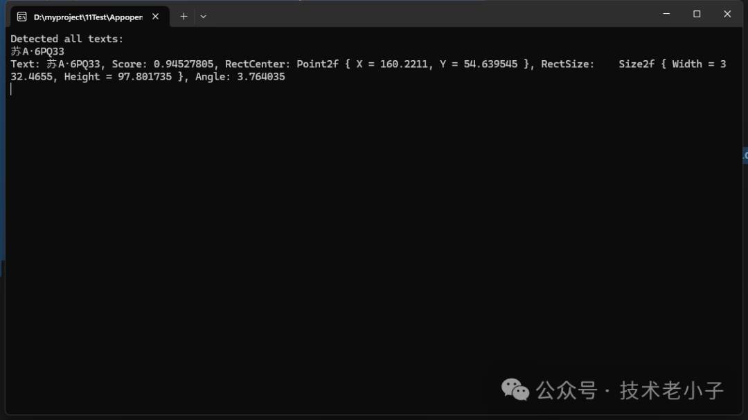

                using (Mat src = Cv2.ImRead(@"temp_plate.png"))
                    PaddleOcrResult result = all.Run(src);
                    Console.WriteLine("Detected all texts: \n" + result.Text);
                    foreach (PaddleOcrResultRegion region in result.Regions)
                        Console.WriteLine($"Text: {region.Text}, Score: {region.Score}, RectCenter: {region.Rect.Center}, RectSize:    {region.Rect.Size}, Angle: {region.Rect.Angle}");
