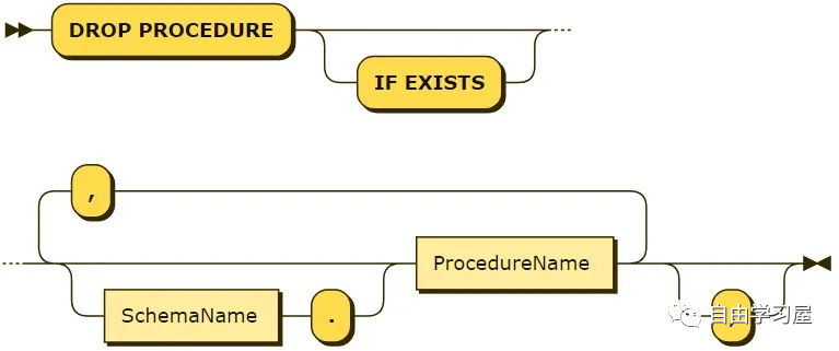

6. 删除存储过程(drop Stored Procedure)
可以使用 drop 命令擦除现有存储过程。
  • 例如,擦除过程 SalesReport 和 insertProduct
drop PROCEDURE dbo.SalesReport, dbo.insertProduct;
  • 如果要删除的存储过程不存在,并且不使用 If EXISTS 子句,则会出现以下错误消息:
Msg 3701, Level 11, State 5, Line 1
Cannot drop the procedure 'dbo.SalesReport', because it does not exist or you do not have permission.
Cannot drop the procedure 'dbo.insertProduct', because it does not exist or you do not have permission.
  • 添加 IF EXISTS 来消除错误信息:
drop PROCEDURE IF EXISTS dbo.SalesReport, dbo.insertProduct;
